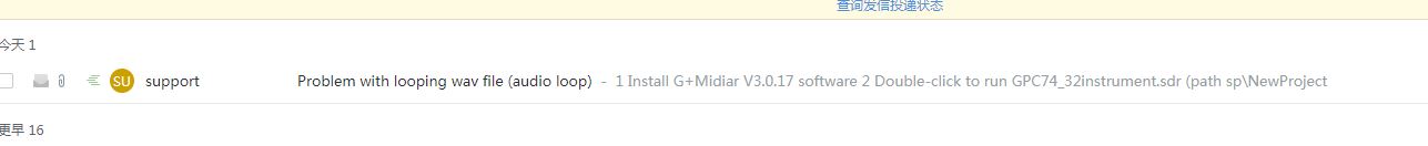

I don't know how to express the tone cycle(audio loop) in English,
picture 1
58 Tb03_20kS1_52(
SoundForge11 processed)
58 Tb03_20kS2_52(SounDop processed)
If the audio file processed by soundop software is imported into G+Midiar, there will be a problem with the loop point of the audio, and the loop part will become discontinuous.

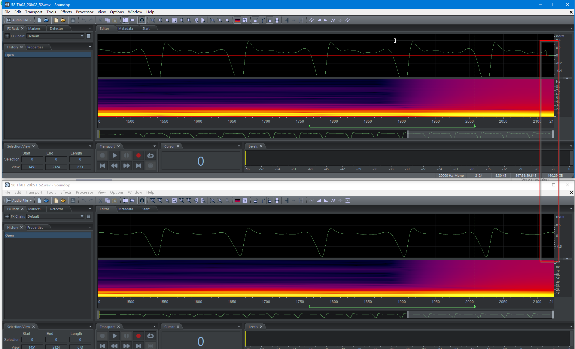

picture 2
This problem does not occur after SoundForge11 has been processed.

It seems to be a problem with the sample loop. Could you give more details about the processing applied to the audio file?
And maybe you can attach the wave files to help us identify the problem.

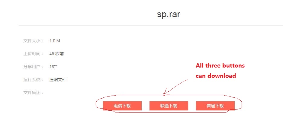

Forum cannot send attachments in wav format
I'm in China, and I don't know what network disk I use abroad. I sent a network disk that I use. If you can't download it, you can provide me with an email, and I will send it to you by email.
https://wwi.lanzouq.com/iFFS7ykzexg

We have compared the two files. The loop position is the same, and there is a difference at the end of the file.
Maybe the problem is caused by the JUNK section. And we have fixed it and will release the fix in the next version.
You can send the original file to support@ivosight.com and tell us the processing steps to further identify the difference.
