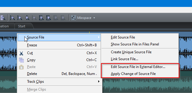

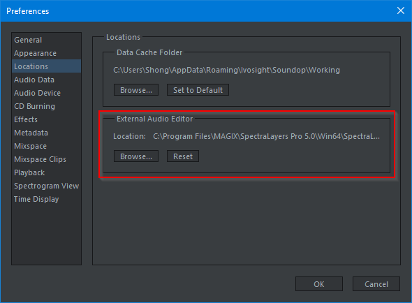

(03-23-2020, 01:04 AM)rotong Wrote: Is it possible to edit portions of an audio file in an external edit like Spectralayers and update the file in Soundop after editing? Hi, Thanks for your suggestion. And we have implemented the feature in the new version. There are two commands added to launch the external audio editor and apply changes. And you can also add shortcuts for these two commands. Please check it out. Best regards.

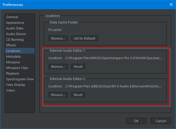

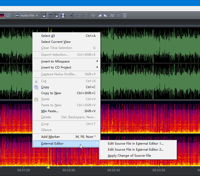

08-16-2021, 01:57 AM
(10-25-2020, 05:54 AM)ivosight Wrote:(10-23-2020, 11:59 PM)London Acoustics Wrote: It would be interesting, also in light of the another thread that says "no ARA implementation planned". Hi, We have released a new version that supports two external editors and opening external editors in the waveform editor. Please check it out. Best regards. |
