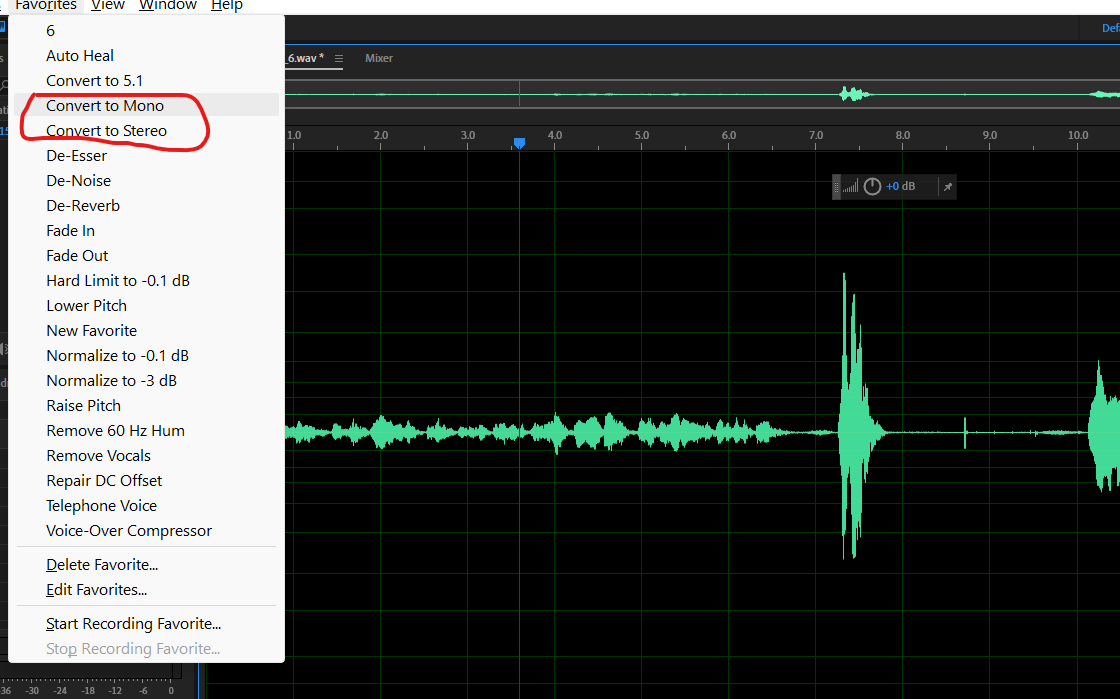

(08-22-2025, 12:36 AM)ivosight Wrote: Is there any option for soundop convert similar to adobe audition?

You can easily create a processor using the Convert Sample Type action.
RE: how to covert sample type - pavelgazi - 08-22-2025
thanks

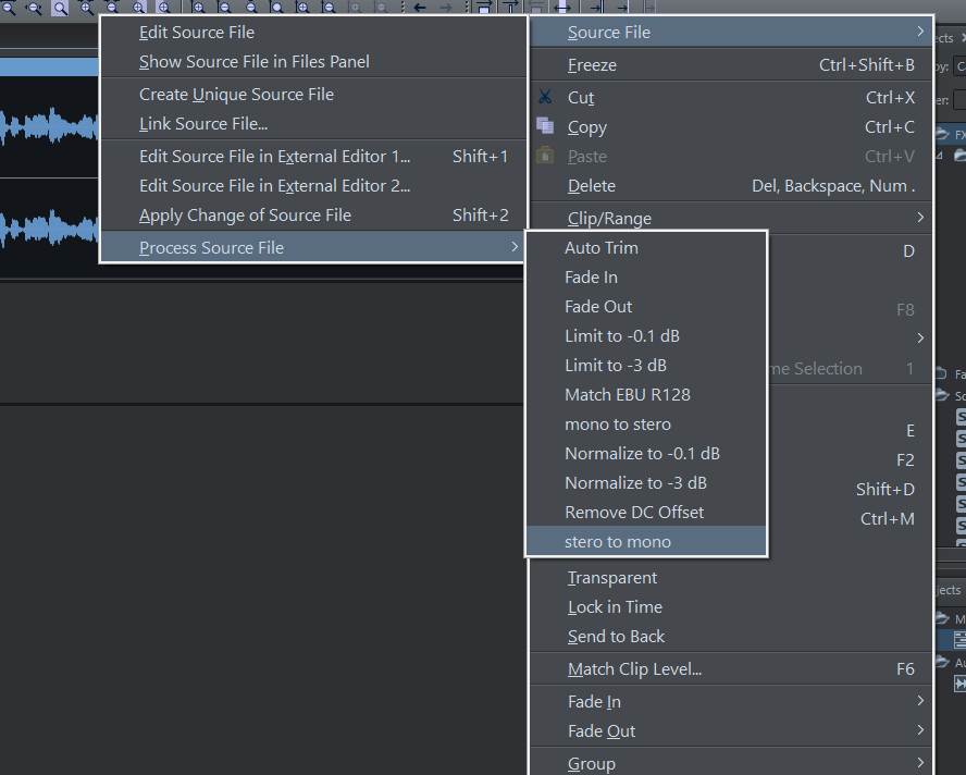

If I want to process a clip from a multitrack, it doesn't work, but if it works by importing an audio file, what is the problem? I want to do it from a multitrack track.
Thank you very much for reporting the bug. We have released a new version with the bug fix. Please check it out.
RE: how to covert sample type - pavelgazi - 08-26-2025
Thank you very much its work
