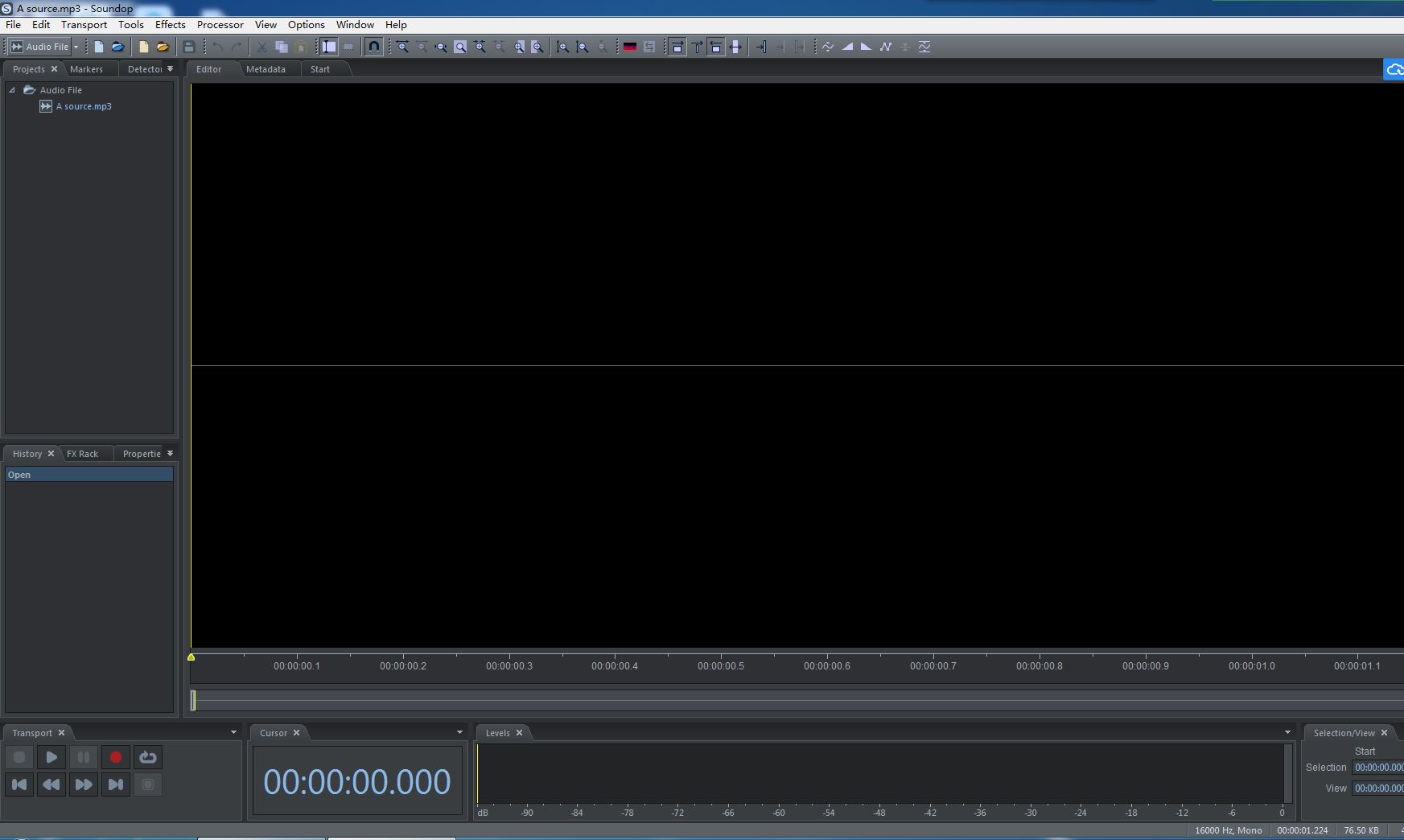

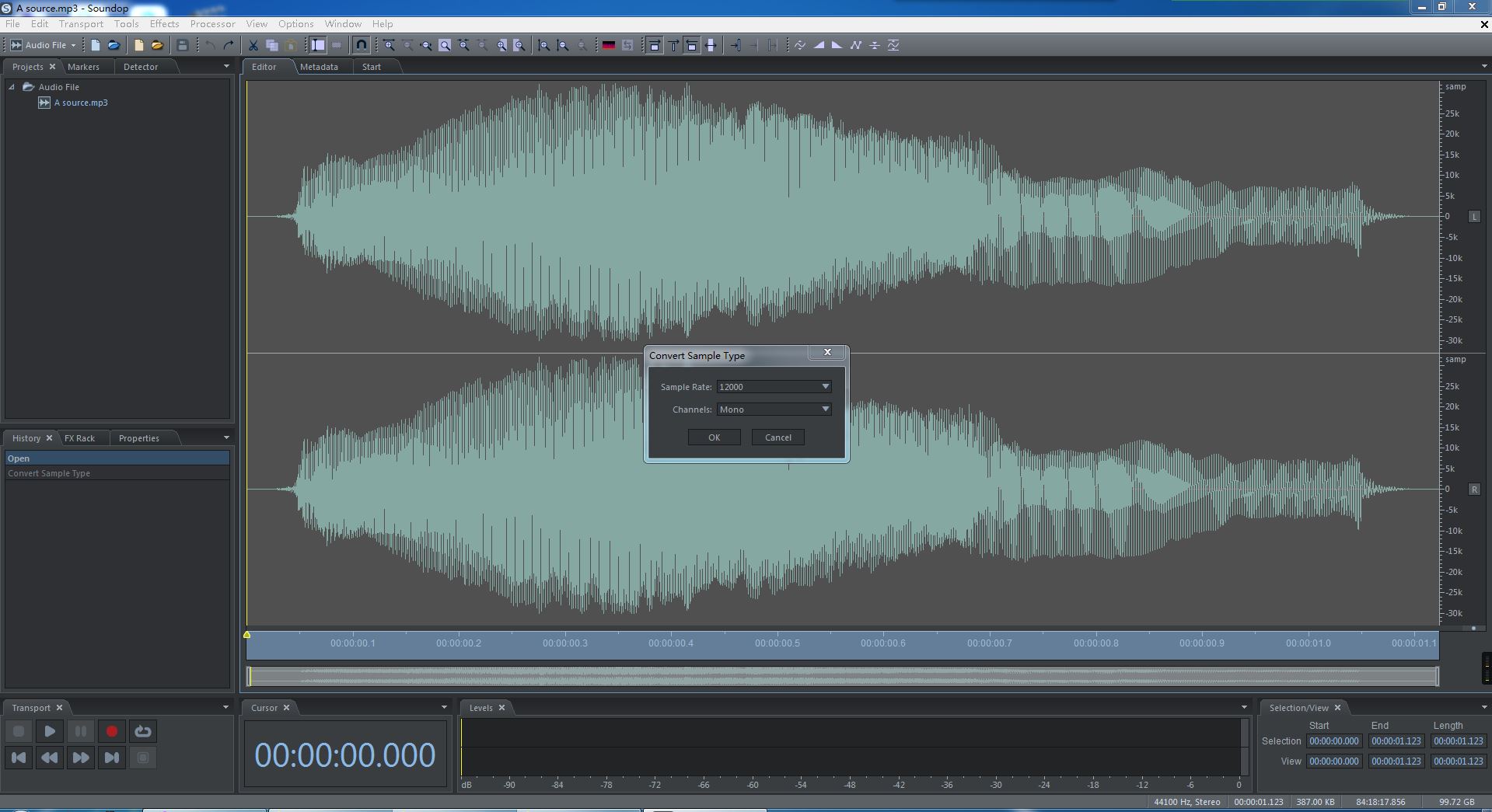

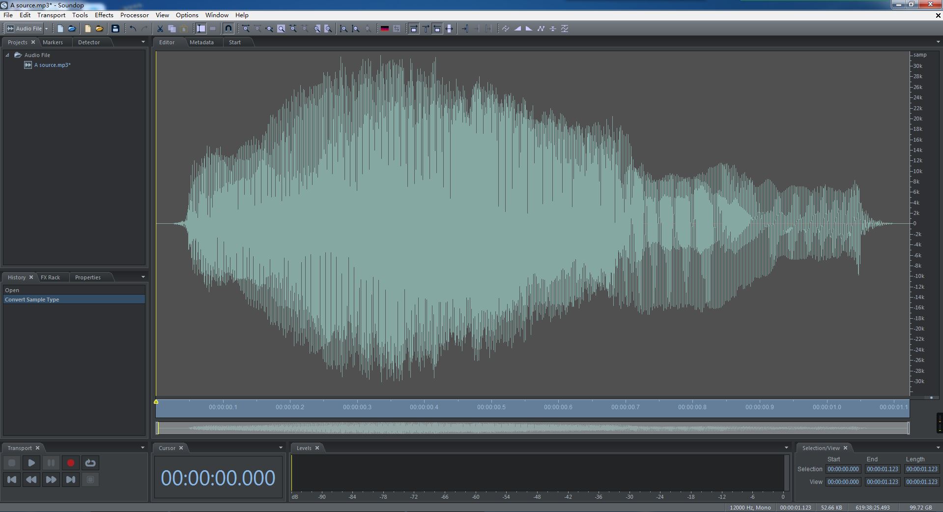

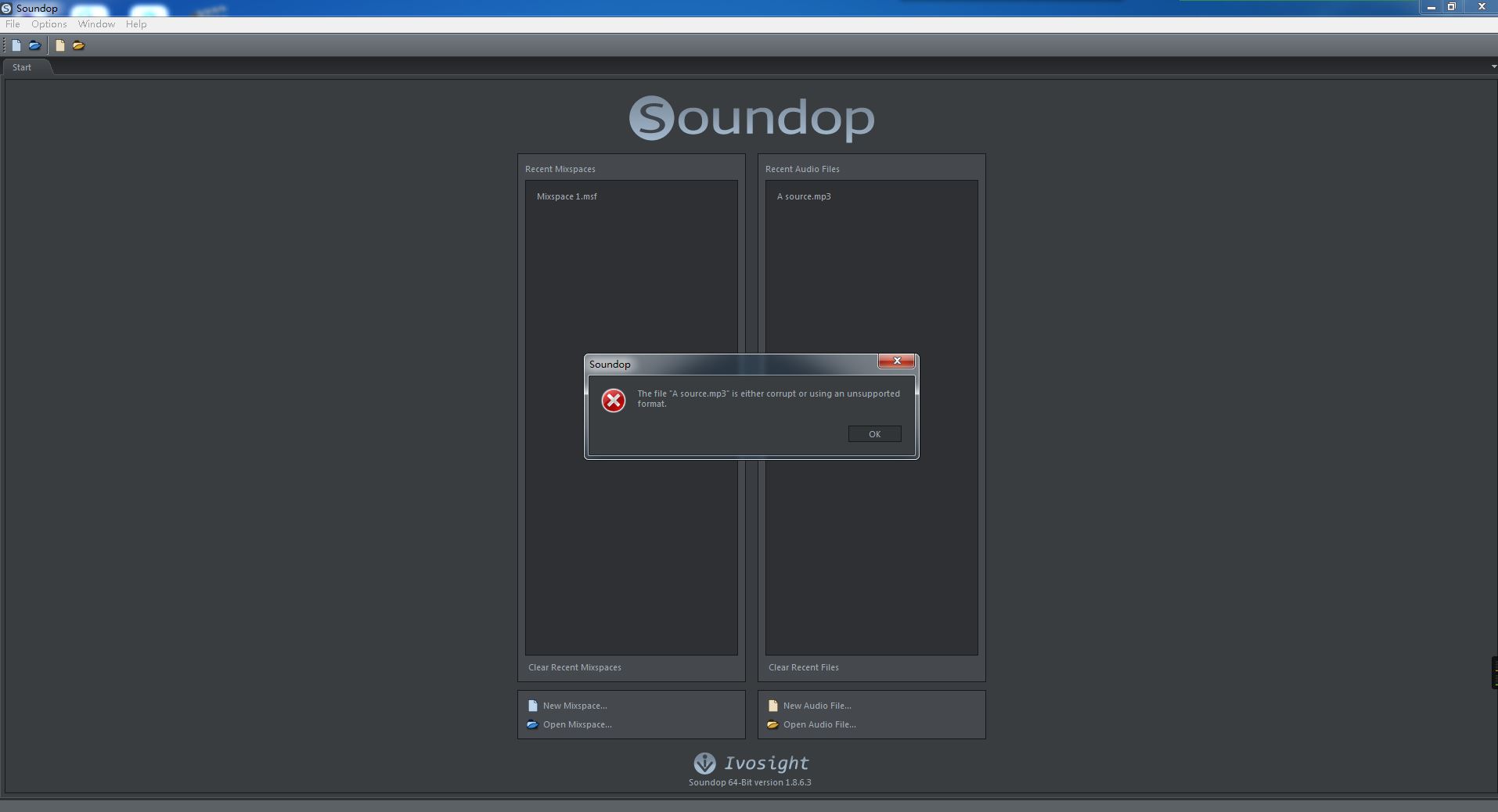

Open an mp3 file (picture 1), select the conversion sampling rate to be 12K, mono(picture 2) , Ctrl+S to save the file, reopen the MP3 file, it shows that the file is in an unsupported format (picture 3). (The file is damaged)

picture 2
picture 3

The sampling rate is changed to 16k, the mp3 file is saved (picture 1), and the mp3 file is reopened and it becomes silent (picture 2).
picture 1
picture 2
RE: About the problems in the use of soundop1.8.6.3 - ivosight - 12-21-2021
(12-21-2021, 12:17 AM)18216239004 Wrote: The sampling rate is changed to 16k, the mp3 file is saved (picture 1), and the mp3 file is reopened and it becomes silent (picture 2).
picture 1
picture 2
Thank you very much.
There is some problem with the saving format when the sample type is changed. Please use "Save As" and change the settings before saving. We will fix the problem in the next version.
RE: About the problems in the use of soundop1.8.6.3 - ivosight - 12-25-2021
(12-20-2021, 10:25 PM)18216239004 Wrote: Open an mp3 file (picture 1), select the conversion sampling rate to be 12K, mono(picture 2) , Ctrl+S to save the file, reopen the MP3 file, it shows that the file is in an unsupported format (picture 3). (The file is damaged)
MP3 attachments cannot be uploaded!
picture 1
picture 2
picture 3
We have released a new version with the bug fix. Please check it out.
