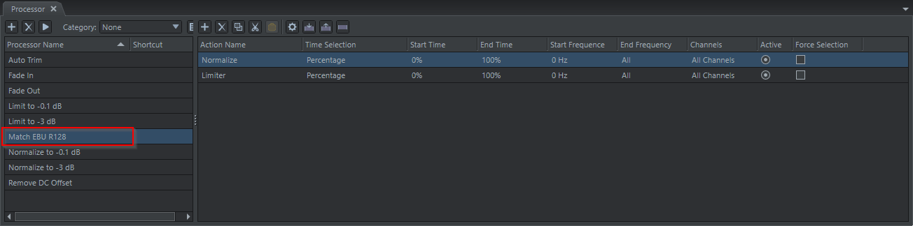

You might consider using the Match EBU R128 processor as an alternative to Match Loudness in Adobe Audition. This processor features both Normalize and Limiter actions, which can be adjusted to meet your specific needs.

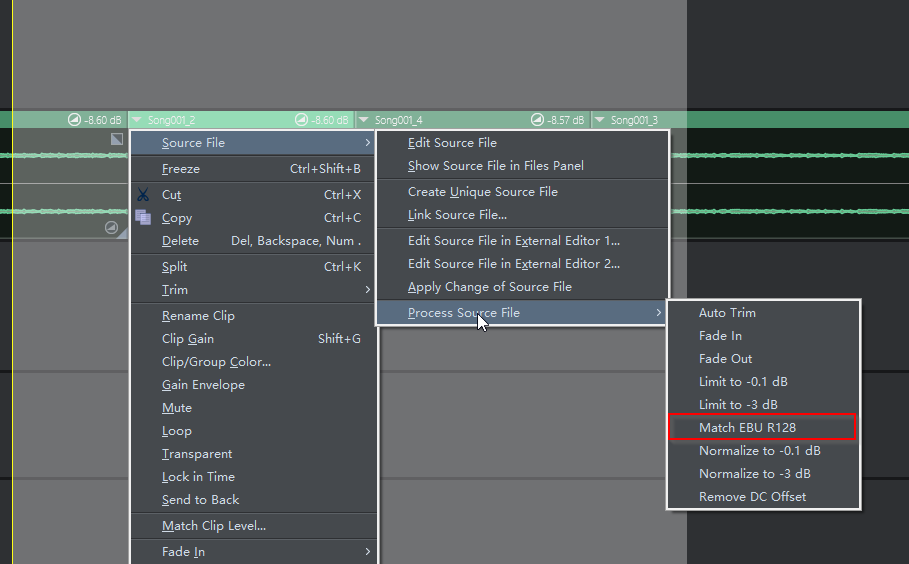

When you use the match clip level function in Soundop, the source audio file remains unchanged; only the clip gain is adjusted to modify the volume. Because of this, a limiter effect cannot be applied during clip level matching, as it would require altering the original audio file. This limitation is likely why Adobe Audition also does not apply a limiter when matching clip loudness.
As an alternative, you can create a batch processor and use the Match EBU R128 processor to adjust loudness and apply a true peak limiter across multiple audio files. Additionally, you can select multiple clips and process their source files with the Match EBU R128 processor. This operation will automatically generate processed versions of the audio files and replace the originals in the clips with these new versions.
If you have any questions or need further assistance with this process, please let us know.
