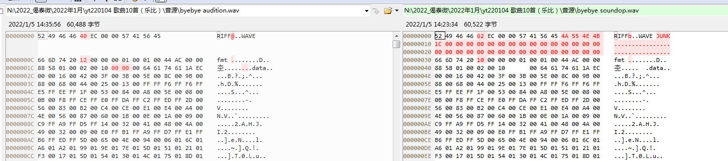

G+audio batch convert is a toy IC audio conversion software (https://www.generalplus.com/). The sample rate of some wav files processed by soundop shows 0 in this software (Picture 1), and the wav processed by audio does not have this problem.

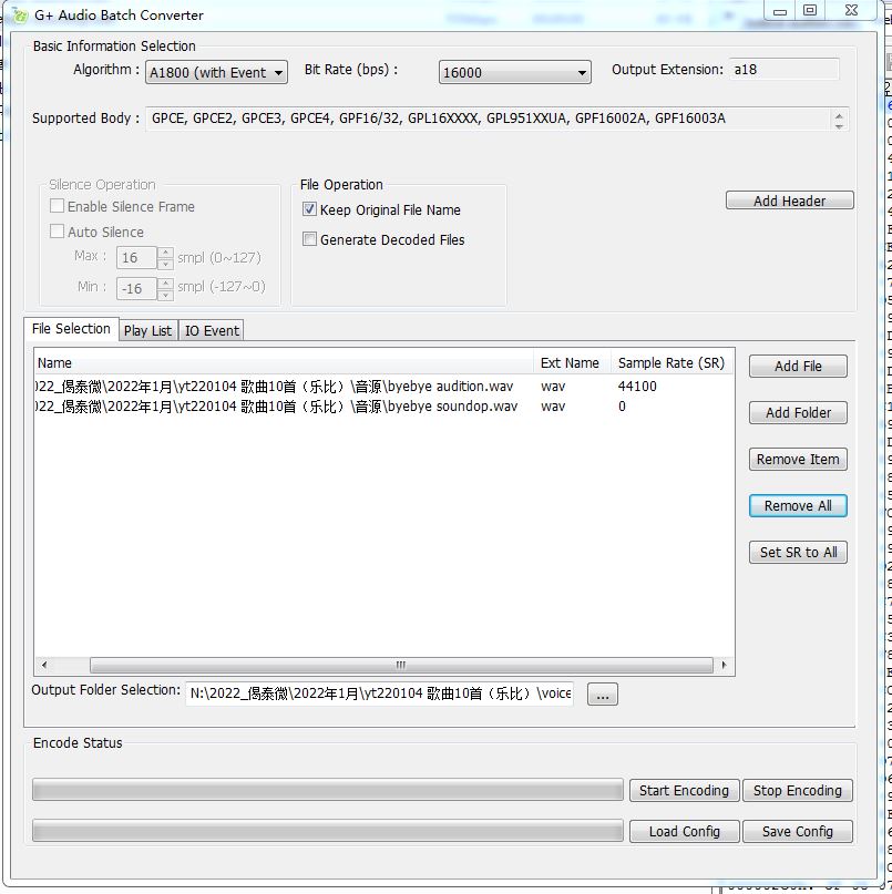

Comparing the hexadecimal files of the two wav files, it is found that the header files are different (Picture 2).
Picture 1
[attachment=194]
Picture 2
[attachment=195]
