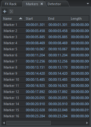

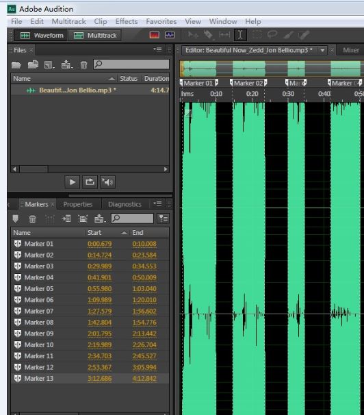

1. The sorting of audio markers is not in the normal order (picture 01), the sorting of other software (picture 02)

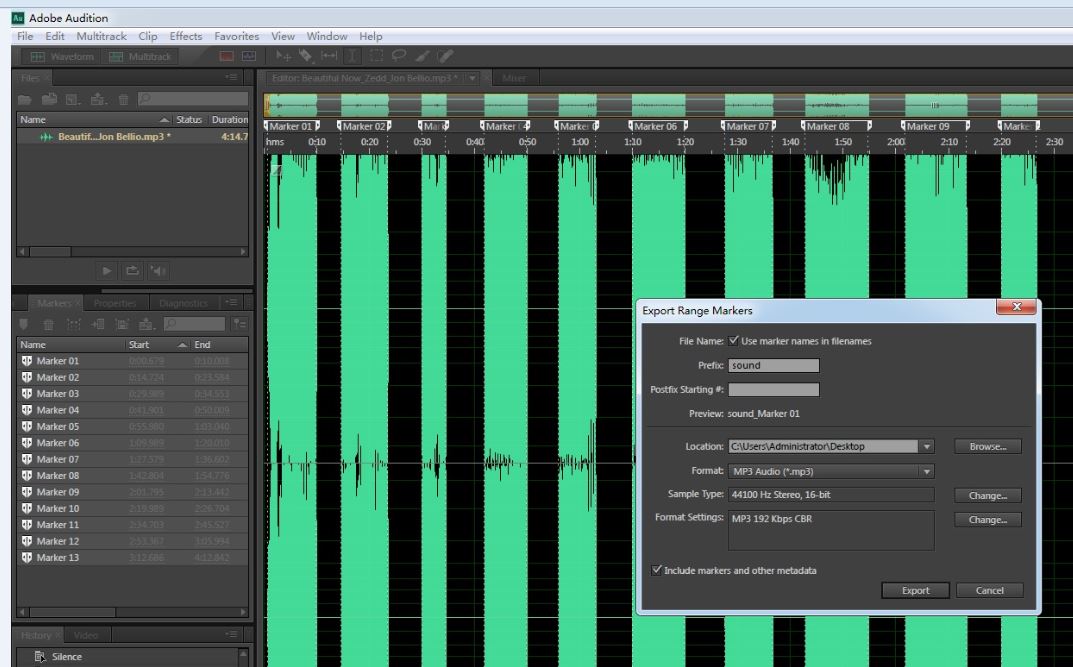

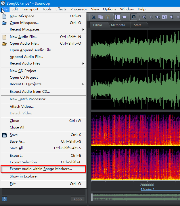

2. Now that the soundop software marks the audio, it cannot save the marked audio as a separate file (Picture 03). Other software has this function, this function is very easy to use (picture 04),
I hope you can consider adding this feature! Thanks!

(12-27-2021, 12:16 AM)18216239004 Wrote: [ -> ]1. The sorting of audio markers is not in the normal order (picture 01), the sorting of other software (picture 02)

We will improve the sorting of markers. And Soundop has support for exporting audio within range markers.
attachment=190]

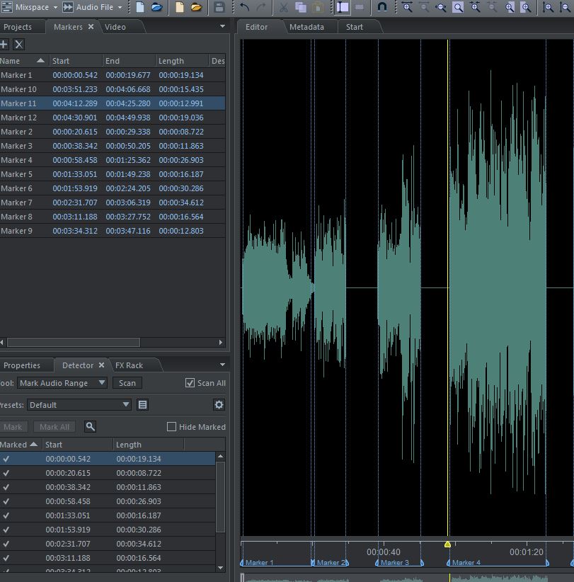

We have released a new version that improved the sorting of markers. Please check it out.
attachment=191]

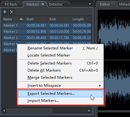

Is it possible to export markers to a txt or CSV file? That would be very useful for me as a podcast producer.
(02-11-2022, 07:21 PM)Ivellios Wrote: [ -> ]Is it possible to export markers to a txt or CSV file? That would be very useful for me as a podcast producer.
Thanks for the suggestion.
We will add this feature in future versions.
Awesome! Thanks. I'm already waiting for this update.
I believe it would be best to perform the export similar way to what Adobe Audition does - it creates a CSV file with marker locations set in format hh:mm:ss.ms. Each marker is placed in a new line.
Not sure about other podcast producers but I publish my podcasts on multiple platforms, including YouTube, and I use markers to set locations for ad slots. I produce a podcast, I put it on YouTube, and then I look at my marker list to see where I wanted to put ad slots. Because of that, I'd also like to suggest some other improvement - some sort of snapping to grid, or snapping to 'full' seconds.
EDIT: Of course it would be great to also have the possibility to import markers.

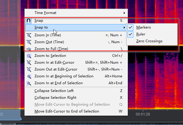

You can turn on snap and snap the markers to ruler units.
attachment=235]

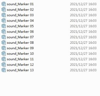

We have added the feature in the latest version.
attachment=236]
Just checked it out, works perfectly. Thank you very much for adding this feature, and for your explanation, too.
