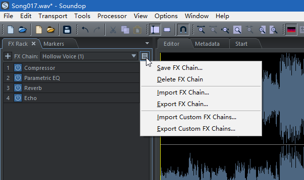

2. We will add support to import and export presets ASAP, thanks for the suggestion.
3. The combo box does keep the name after the preset removed from the drop list. And this is due to our design to save the preset name for the current settings. We think that's maybe more preferable.
Importing and exporting VST presets has been supported in the new version, please check it out.
[attachment=85]
[attachment=86]
